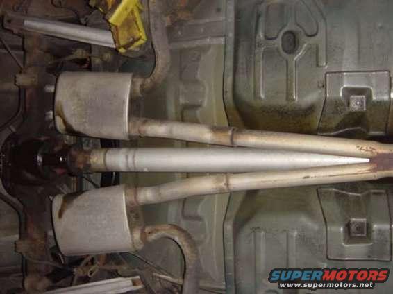

    if you do them that way use same side inlet/outlet mufflers. That way you wont have to worry about ground clerance.
    Look up the 2000 cobra R exhaust to know what I mean. Thrush along with flowmaster make them. C4 vettes used the same style.
  3. maverick75
    9,014
