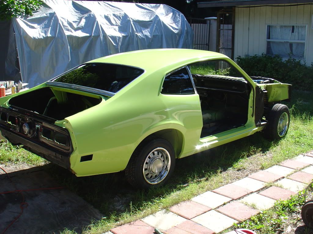

    Here are some rims I just put on my project car.

    I could have had a set of those but i have centerlines on it right now.
