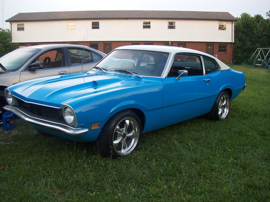

    Heres one from Mean Maverick his are 17x9 with a spacer.

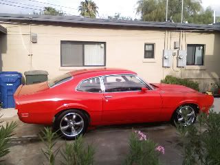

    here is min. 17X8 on the front and 17X9.5 rear. Wheels are Hopsters by AR

    You will also need spacers if you don't have the one's with 4 1/2 inches a backspacing.

    That looks sharp! How'd you lower it?

    with a spacer... the backspacing is what you need to worry about, you dont want it hitting the leaf springs. otherwise stick with a 4 1/2"

    620 lb spring on front with 1 coil removed and leafs de-arched 3" in the rear.

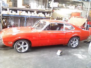

    We have since lowered the car, but don't have a picture yet of it. These are 17" Torque Thrust.
