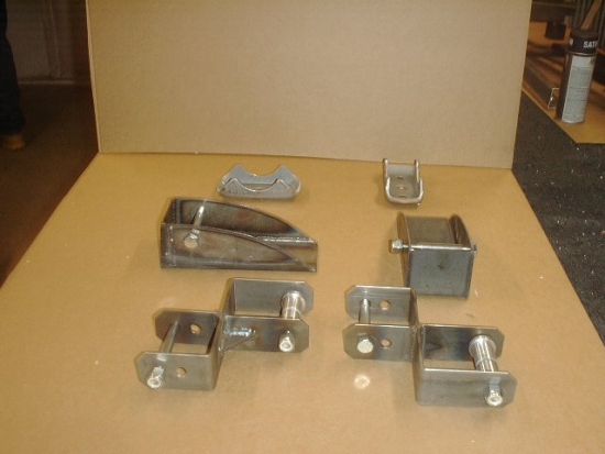

    Has anybody used this kit from crites??
    1965 - 1970 Mustang
    Spring Relocation Kit
    gives you 6" more tire clearance
    Specify Year
    $169

    that kit only moves the springs 3"
    6" more tire...you may need to do a tub/frame notch.
    I'm in the planning stage of moving my springs in 3" and that will give me 1.75" more tire width without mini tubbing/notching frame. I can run a 275/60/15 now.
    step #1 was centering my gas tank...done
    step #2 I will remove my frame connectors.
    step #3 move the springs in 3".
    step #4 replace frame connectors.

    You'll need to remove the factory "bump stops" and brackets, along with scalloping the rear frame rails to get any appreciable benefit from this kit...

    I have run 275 50 15 nitto drag radials with weld wheels with three and a half inch backspace work well.I am currently making my on a set of Caltracs so it will hook.I've got a set of Hoosier 26 by 9 Slicks.

    Your not going to be able to get much more tire under a maverick than a 275 without mini tubbing.
    I've got 285x35/17s on mine with tci torque arm suspension and their is no way i can put a wider tire on it without mini tubbing.
