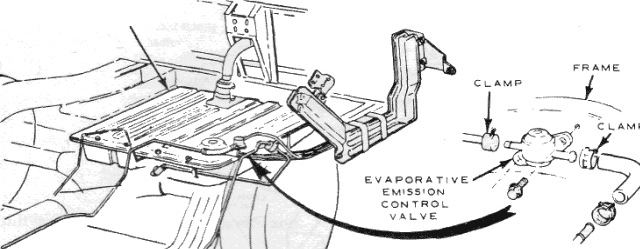

    ford maverick 1970 3.3 engine (200 cid) what is this 6 lines coming from the fuel tank last day in the gas station i put gas on it but the fuel was get it outside from ther i need the name of were it was conected to buy it and know how to connect in 6 lines attention is not the principal fuel line the one it goes to the fuel pump and engine

    Looks like part of the vapor evap system found only on 1970 California Mavericks. The parts are impossible to find...or at least very tough.

    what is the plastic container for thats in the trunk?

    can i just cancel it?
