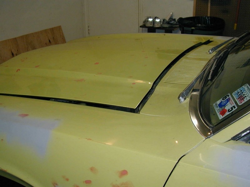

  5. scooper77515
    I did the "poor man's cowl"...
    It breaks the lines of the car just enough that I sorta liked it and kept it. I always felt the front half of the car was too thin (top to bottom) and this kinda gives it a little transition from thin up front to thicker out back. (Mine's the yellow one, not the orange one :biglaugh:)

    well here is the first day of work. added pics of the hood that i started with and what it looks like right now after i cut out the whole center part of another hood and overlapped it to match the lines up then formed the rear to give me a 2in cowl i think it looks good just have to do the body work on it but all the welding is done

    thanks guys yea my dad says it almost looks like a early camaro factory cowl hood but i havent looked it up to see for myself its not huge so it doesnt jump right out at you
    heres a pic of what i cut out of the other hood and a pic from before i took the hood off the car to start welding it

    Now that's using your dipstick!:dance: I like it, looks almost factory!

    thanks thats what i was going for something that you have to take a second look wondering if it was stock or not. kind of like my cowl i cut out the vents and welded it up for a flat clean look.
