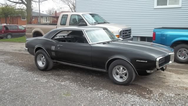

  13. Derek 5oComet
    Derek 5oComet Tire burner
    Dec 4, 2005
    1,629
    Welland,Ontario,Canada

  15. Derek 5oComet
    Dec 4, 2005
    1,629
    I'll get you a better pic of the Firebird it's really more of a semi gloss.I don't know what flat clear is worth where you are but it's about $450 a gallon here.
