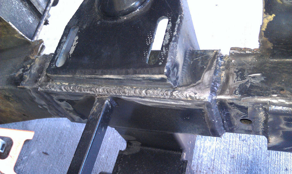

    After cutting all the old suspension off, and I mean ALL of it, including the strut rod bar up front, because it gets in the way when installing the long bolts that hold in the lower A-arm. I was hoping to keep it, because it makes a great jacking point, but no luck.
    After welding it up, and realizing that my welds were crap, I spent the past 2 or 3 weeks trying to track down a mobile welder to come and do it right. It was already centered and measured, and put where it belonged, so he just had to grind out each weld one at a time and reweld it.

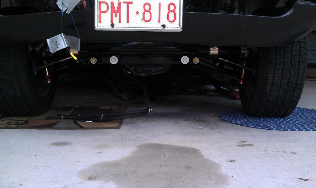

    I have the wheels sitting on rugs, so I can move them pretty easily. I lined them straight up, then pulled them in about 1/4" to get the toe approximated. Slipped on the connecting rods, centered the steering rack, and put the connecting rods onto the spindles. Torqued them all down, cotter keyed all 6 joints. And done for the day.

    Currently, without engine, car sits pretty high.

    I got a PM saying that the rotors are on the wrong side in my pictures.
    Are those grooves direction-specific?
    And what would be a good jacking point now and later when the engine is in? Could I jack at the bottom of those tabs that hold the shocks?
  14. Dave B
    Yes, they are more than likely directional, and no I wouldn't put a jack on the shock tabs, use the torque box, to jack up the front.
