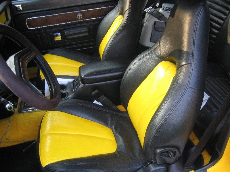

    I have posted this pic a couple times before...but here are '93 Ford Probe seats in my Maverick:
    The seats are rather wide and are a tight fit. My car does not have a catylitic converter, and the install was not real hard. I had to add spacers for the inboard rear mounting holes. None of the original holes lined up. I currently have large washers to help stop the seats from ripping from the floor in a crash...but I would feel better if I tied a flat steel bar across the rear two bolts from underneath or something.
    I have found the seats to be really confortable and I think they look pretty cool in a Mav. These ones originally had black and white leather covers, but I dyed the white yellow to go with my crazy color scheme. :D

    Mavmark, I know this an old post, but what is that center council out of? I'm considering probe seats as well

    That console is aftermarket and called a "Humphugger". I got the one for a early Mustang. I think at the time I bought it from Auto Krafters, but it looks like it is still available and from lots of other places...and in all kinds of colors as well. Here's a link to one of the places I found it:
