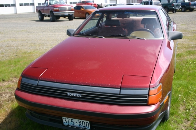

    As I mentioned earlier I have a couple extra Toyota celica fenders that I thought about using... here is a picture to let you know what I'm contemplating
    You can see how the top of the fender goes up, in, up, and in again. I was thinking that wouldn't look to bad as the side/riser pieces of a cowl...
    I still really like the looks of the 429 scoop but I was getting tired of having to plug the hole with a piece of foam every time it rained...
